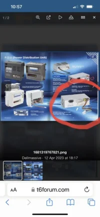

A few notes that may help:
1) There's definitely a charger in that PowerPart box (they refer to it as the 'power supply'), unclear what the spec of the charger is. (Powerpart PDU & Converters Wiring Harness Kit)
2) The control panel has options to enable/disable charging the leisure battery... check here: https://bcagroup.co.uk/wp-content/uploads/2022/09/Seattle-Manual.pdf
3) If control panel options are missing, this helpful person explains how to get into the manufacturer's menu, although there's no point enabling options if there's no hardware to support them, so be cautious:
Maybe something here that will help?
Don't forget a power supply is just that.... A power supply.
It's not a smart charger. It doesn't have a charge profile, or temp compensation, or current limiting etc . It just puts out a fixed voltage... Normally about 12.6v or there abouts.
That won't properly charge a AGM battery as they need a higher voltage to be charged properly.
Fair point regarding smart chargers. But the battery should charge, even if not fully - which is why I wonder if there's a control panel setting somewhere.
One of the power supplies shown in the photos claims to be also a “Dual Stage Battery Charger” maybe there’s one inside the Power Part box.7B11EEFE-662C-4AA1-BAD9-DC1BEBE6F7EF.webp
