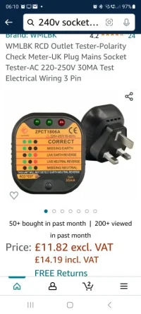

These 240v socket testers can be helpful to trace issues.

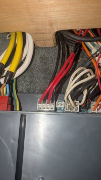

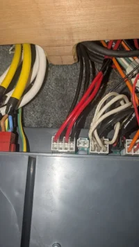

Hoping to jump on this and maybe my wiring might help someone else too. My van has one of these power part PDUs and the 240 volt charger works but not the split charging.
On the 8pin on the left I have 14v (with engine on) going in, but it isn't charging the leisure battery. Wasn't sure reading this if I am missing a ignition wire? Anyone know where that would go is it the two next to it?
