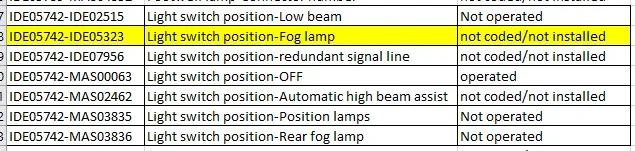

The BCM can report light switch position. Does it "see" fog light switch operated - does it see other light switch positions?
In OBDeleven under live data - search for "fog".
Hi,
Thanks for the answer. I just checked the live status of the switch, and it's written for the fog lights 'not codded'.
Surprising, because I put all values mentioned previously for the "Leuchte 12&13".

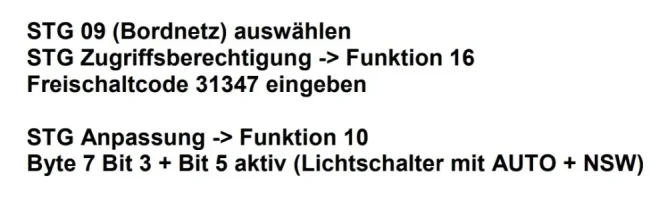

Also, in the instructions provided by the company who sold the kit, it's written to activate byte 7 bit 3 and 5. But I did not find how to do it in the long coding, nothing about byte 7 - any idea ? Thanks
It doesn't make sense - the Function 10 is the adaptation and there definitely are no bytes to work with. Are the instructions for T6.1?
Hi,

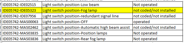

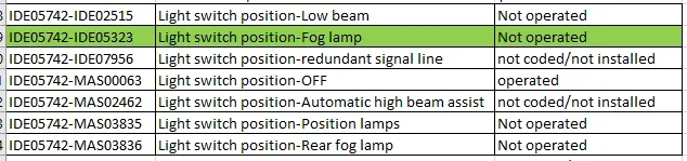

I'm not sure if this helps but below how the light switch is seen with VCDS - do you see the other switch positions correctly?
a) van with fog lights - light switch OFF
(b) without fog lights - light switch OFF
Yes, when switching on and off the other lights, I do see the correct status. Just the fog lights status is not modified and stay on not coded :-(

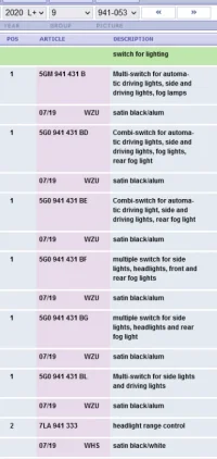

Here are the light switches used in T6.1 - they are exactly the same part as used in previous generation(s) of Golf, Tiguan, etc.
