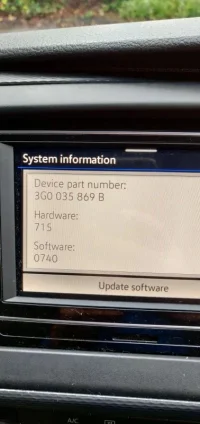

So after the service and asking for any updates to be installed it doesn't look like the garage has done anything, it's due back in on the 4th anyway so will have another go:
Nov 2020
Today:
Can someone who has it fixed confirm what software version is shown on the head unit?

I don't really understand what software is being updated. The pictured "working" head units above are showing 0740 when there is talk on google support saying its fixed in 0743.

Got the van back and they applied the software update to the head unit. It now shows as 0743 which is the version Google say contains the fix and it's now working for me. The Android version itself still shows as 0740 which is weird.
In any case, if you want VW to fix it and they are being weird, then ask for the specific software version
Just finally had my system updated to 0743.
I asked for the stero to be update, they told me there wasn't an update... I spoke to the guy who actually does the work in the workshop at VW, he got the van plugged into the system again and showed me, it definitely said the system was current and there wasn't an update. When we checked the van the version had changed to 0743 and it now all works perfectly! He said it may have been automated as he didn't actually have to do anything.
