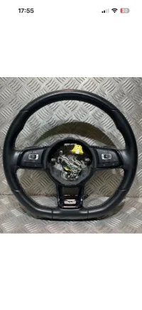

I’ve bought a new flat bottomed & reupholstered wheel and it’s come with buttons. I’m reusing my air bag & currently waiting on a new leather & grey stitch airbag cover for it.
All looks the same apart from the middle button on the left. Mine is blank & the new wheel has a button for what I think is ACC (?)
I’m guessing I’ll need to transfer my existing buttons to this new wheel & I’ll be good to go, just wanted to double check I’m right before I remove my wheel & risk spoiling another weekend trying to make the van nicer.
