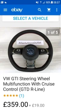

Your inlaws wheel would fit as long as your van is dsg which gather yours is.
Have a look at this seller on ebay had mine from there and few others on here, just make sure you get same buttons as yours with dsg as he has a few for sale. And yes straight swap plug and play
Hope this helps
Cheers andy
I looked for ages for wheel to match ,just check all the buttons match exact .
Some golfs with acc buttons are different to a t6 .
I got a golf 7 /passat flat bottom wheel with dsg and swapped the buttons and air bag over from my wheel .
