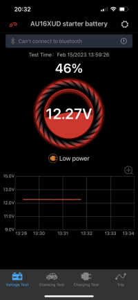

For about a month I’ve been monitoring the starter battery with a BM2, as recommended on here, so that I know when I need to connect an external charger.
For context it’s a 2016 Euro 5 with Stop Start BM. It’s a campervan conversion and it doesn’t get used much this time of year.
The battery is an AGM Varta - is this likely to be the original battery?
As you can see from the graph and screen shot it generally says low power and sits around the 50% mark. So my question is, is this normal or does the battery need replacing?
Thanks. Nick
That looks fine to me. Our van of the same age with original battery sits at about that voltage.
It easily lasts 4 weeks (if we leave it that long).
Batteries generally have some sort of date stamp on them, but it can be hard to find.
Pete
as @Pete C says that trace looks normal.
its more about the voltage over time than the xx% reading.
so as long as the voltage stays above 12.1v you are all good.
if it drops below 11.99v then it needs a full charge.

FYI - you can tweek the battery settings an the BM2 settings page to adjust the XX% trigger points if you wanted.
ie create a custom profile and set 00% as 11.8v and 100% as 12.4% - and see how that works for you?

Thanks @Dellmassive, that’s reassuring to know. I didn’t know about the custom profiles either so I’ll set that up.
