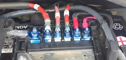

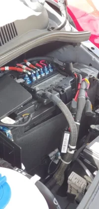

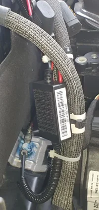

I finally fitted the BM2 battery monitor today. Before fitting it, I added an inline fuse (with 2A fuse) with a couple of butt crimps in the +ve lead to keep everything safe. If anyone else does this job, note that the leads from the BM2 have two small insulated wires running through the outer sheath. These are connected together in the crimp connector.
As you’ll see from the accompanying pictures, I secured the +ve lead to the spare +ve connection terminals (second from right) on top of the battery, and the -ve lead at the battery hold down point which was doubled up with the -ve lead from a CTEK plug. As there wasn’t quite enough room on top of the battery, I secured the BM2 unit to the loom with cable ties. Setting up the app was really easy and took about 2 minutes. The only disappointment was the Bluetooth range; about 9 metres maximum.
After installing, I measured the actual battery voltage with a Fluke meter - it showed 12.89V. The battery voltage displayed in the Battery Monitor app was 12.90V and the voltage reported on my tracker dashboard was 13.2V, so it looks like the BM2 is accurate enough.
