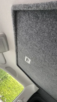

Anyone had an issue with the sliding cover dropping down when closed? I noticed it was slowly getting worse so I contacted skyline and they sent me the attached clasp which I have to say is dog****. And has sharp edges so can see one of the kids catching their heads on it.

So I did this. Found this clip on eBay and fitted it. Works well.

I really like this. Does it work well? Mine can be tough to get in exactly the right place.
It’s totally hidden when closed which I like and feels solid. The only issue is because you lift first before sliding back, it’s a bit stiff until you drop back down.

Could you please post a link to this product.
Thanks
Thanks mate.
Sorry but I'm interested in the locking mechanism in photo 150060:
