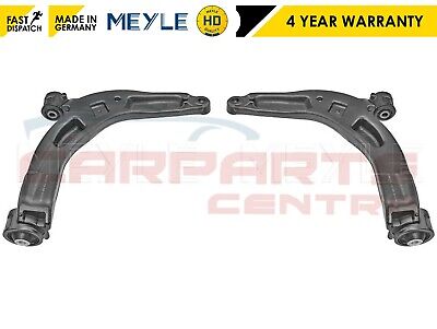

Hi you don’t have a link to them by any chance
I got them from Murray Direct on Ebay but they dont seem to list them anymore, only the Meyle bush kits. Cost £210ish for the pair.
Hope thats not the picture of the real thing as its wrong! Transporter lower arms are a hunk of cast iron, not pressed steel and the bushes are wrongly orientated in the pic above.

These look like the correct ones but check against the vehicle listing or confirm with the suppier…

Thank you for your replies, The link to them is still good and just ordered a pair :)
