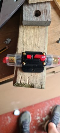

I have no output from the unit despite having checked the wiring 5 times.

bit late to party.
but as you found out those cheap Chinese copy breakers are terrible for any current carrying loads.
swap them out for a good MIDI stle fuse and holder.
check your powers and grounds are all good, clean and tight.

Cheers - fired up immediately with a normal fuse. Will never use them again ! !
