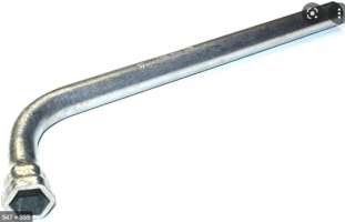

this . . . .

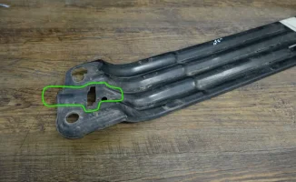

goes in here . . .
as a lever to lift up the heavy spare wheel.
basically a long bat that adds leverage . . . to lift it up./
not done it myself . . .
but noticed it the other day when i had out the tyre doing the tow bar install . .
i never knew . . . over 10years Transporter ownership,
and probably over 20 spare wheel changes. . . !!!
no told me, and its not in the owner guide either.
i just saw the tyre support bar . . . and thought,
why would they press that steel into that shape? - it looks like it takes a bar or something.?
then the penny dropped.
