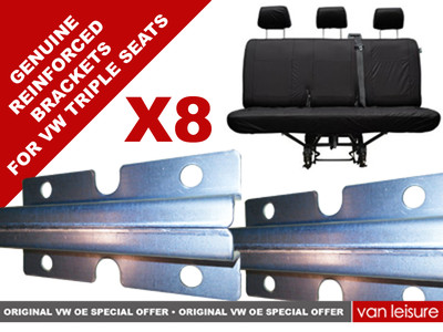

hi there , i am new to The T6 forum and i had a vw T6 van 2016 that i am converting to a kombi . i have brougt a 3 seater bench seat from a t6 , this the one that is held in but for quick release brackets , i have the brackets , i dont have the reinforement plate as not sure which ones i need or how many . does anyone know and also diagrams of how to fit them . thanks in advance
You will need 8 of the double reinforcement plates, even though in your arrangement you will only use one hole in each.
As @Foggy says with the brackets. It’s pretty simple if you follow the guidance earlier in the thread. Once you are under the van you will see where they go. The biggest part of the job is getting all the underneath stripped to access. All the plastics need to come off, split the exhaust, un-clip the handbrake cable then you need to drop the tank to get the exhaust heat shield off.
Drilling and fitting the brackets doesn’t take long. I fitted my 1+1+1 last week.2BA8C922-028F-4193-854C-2AD39ECE88BA.webp
