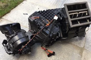

Wiring info
The connecter that the heater box loom (attached to the heater box) plugs in to on the van is not there. The part number for the plug is ‘6Q0972777’.
T17A (connector above heater box)
1 - Fan +12v (red/yellow) - from old fan switch (black/blue) T5F pin 1
2 - Fan earth - from old fan motor (brown)
3 - N/A
4 - N/A
5 - +12v Fuse 15 on holder C (red/grey)
6 - Ground (blue/red)
7 - AC compressor + (pin 1) (brown)
8 - Pressure sensor (pin 2) (brown/black)
9 - Residual heat relay (yellow/ green)
10 - N/A Heated seat (pink/ yellow)
11 - N/A Heated seat (orange/black)
12 - CAN+ (connect to radio twisted pair)
13 - CAN- (connect to radio twisted pair)
14 - N/A rear heated screen(green/brown)
15 - N/A coolant shut off valve
16 - Centre vent temp G191 (brown)
17 - Centre vent temp G191(brown) ground

Wiring loom:
