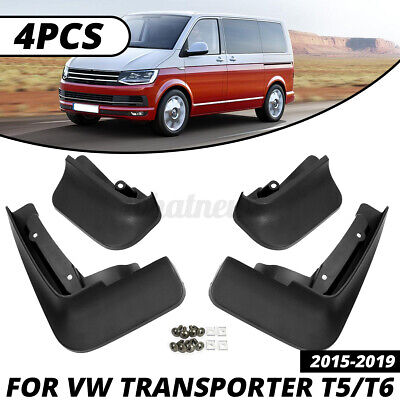

Anyone got a uk supplier for these...I can only find chinese ones that take forever to arrive
Mine arrived within 9 days, and had a London address on the packaging, but the ad states they’re based in the Far East ..
F+R Mud Flap Splash Guard Fender Mudguard For 2016-2018 VW Caravelle T6 Multivan 710731537583 | eBay
Well, they arrived 9 days later.
The instructions are in German and refer to a BMW E38 (7 series)... but they fit fine, using the existing wheelarch plastic cover mounts.

I’ve just purchased a set of the moulded type a few others on here have got... they arrived this afternoon so not had chance to fit them yet. They didn’t come with any fitting instructions, but it looks pretty straightforward.
One question though - what are the small metal clips for (circled)? Has anyone else used these during fitting?
@Ayjay - did you get the same clips with yours?
I've fitted these on the rear and didn't use the clips. They're firmly on the van after a couple of thousand miles. I haven't done the front yet because it has OEMs on the front.
Mine came with the same clips but, like Dave, I didn't use them as I fixed to the existing holes only.
