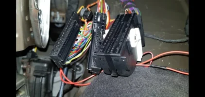

"There are few ways to get mirror blinkers wired up, but I took the feed directly from the BCM/CEM 09.
PIN 14 black/white on plug B is for left hand side and
PIN 15 black/green on plug B is for right hand side.
Obviously "-" for both can be connected locally on each door main earthing/ground point."
You don't have a photo do you, as don't seem to have anything like 114/15 pins. Hmm.

Cheers Robert. Like you, I’ll be making the original indicator redundant, so instead of meddling with the BCM, I’m trying to keep it simple and use the redundant wire
It is absolutely good idea and I have never explored it any further once I realised how simply it is to take the feed from the BCM.
When a first did it I poked through the side of the bellows between the wing and connected to the side repeater. I’ve since removed this and connected to the BCM under the dash.
