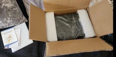

back home in Blighty this is what arrived . . .
a well packaged lifpo4 . . .
it come with a set of bolts, and a install guide . . .

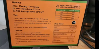

its good to see the info of the lable on the battery. . .
and they make good point about charging and discharging outside of these temps. . .
NO Charge below 0c.
No discharge below -20c.
this is because, as far as i can see there is no LOW TEMP Protection in this battery. . . . . .
No charge blocking - Nothing.
Its down to you to ensure your setup has the required cold temp protection.. . .
Low voltage protection, not tested yet - the sticker shows 10v - 14.6v.

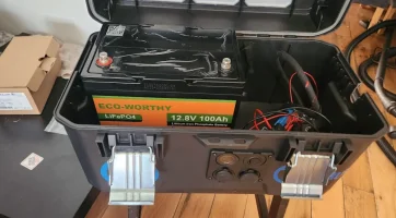

the first thing i do is get it into one of my battery boxes, it fits nice.
a slightly different shape than the Renogy and Poweroad - but fits all the same.
the battery box already has a Victron Smart shunt fitted - so ill use that for monitoring for the meantime.

this is it dropped into the battery box and linked in.
we have the 50A MIDI fuse block,
with 50A Andersonn conectors for IN & Out,
plus the Victron Smart Shunt for voltage and capacity monitoring. . .

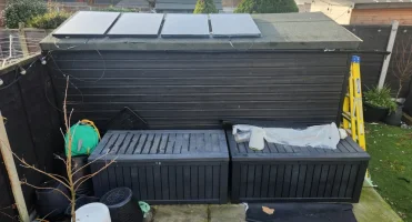

then we get it right on charge from the solar shed.
that was then . . . . .
two months later. . . after forgetting about it. . .
weve moved on a bit.

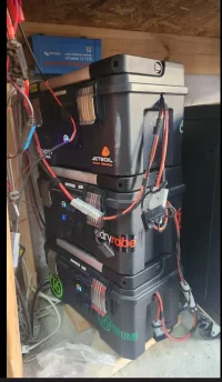

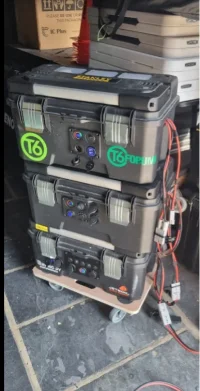

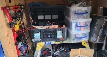

its been added with another two battery boxes.
they hold the HEATED Poweroad 100Ah lifepo4`s.
and are all connected together. . .
we have three 100ah stack giving us 300Ah for the solar shed.
that's all charged via the 100/20 MPPT Victron unit, with 400Wp solar up top.>

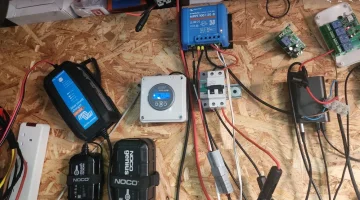

monitoring is via the Victron shunt . .
temp control is an issue as the Eco-Worthy doesnt have low temp protection. . .
so while the battery is connected to the stack I've set the 100/20 MPPT solar charger to default LIFEPO4 charge profile.
this profile limits charging below 5c.
BUT. . .
i doesn't have its own temp sensor, you need to add one,
i have a smart battery sense and a temp sensor on the Smart BMV that shares the temp data, , ,
that means it wont charge when its loo cold. . .
NO Charge below 0c.
View attachment 227367View attachment 227368
View attachment 227369View attachment 227370View attachment 227371
BUT. . .

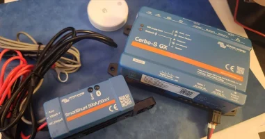

following on . . .
this is the temp sensors . .
and they feed via BT into the MPPT. . . .
they all connect in to the Victron Cloud APP.
im running Venus OS on a raspberry Pi, atm.
but you can also use the CERBO GX,
or the new CERBO-S GX ( perfect for us van dwellers)
you can also add in the BT RUUVI sensors for temp data -

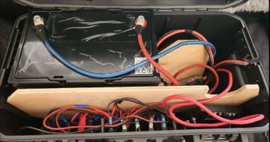

I’ve recently installed two Eco-worthy 100 ah batteries with a Eco worthy battery monitor to my van and they seem to be working ok but I have not used the van with this set up yet for camping, my first time will be the spring T6 meet this year.
I have been charging my Jackery 1000 power station from the Eco worthy batterys and using this in my garage, I also have fitted an isolator from my Victron charger, my Sterling B to B and my Victron solar set up so that no charge can go to batterys when below freezing.

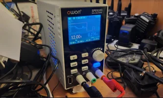

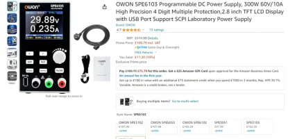

Got a new Bench Power Supply
:mexican wave:
(0-60v / 0-10A) (300w max)
its sweet . . . . my previous two bench supplies were 0-30v / 5A so this is a power bump
it will do 12v (upto 30v) @ 10A no problem. . .
but it will also do 48v @5A (48-52v) range for the Domestic solar stuff
nice . .

a very good point. . .
IMHO . . . these days, in 2024.
all Lifepo4s should have, as part of the BMS:
over charge protection
over - discharge protection
over current protection
high temp protection
low temp charge protection
BT APP or SoC display
But . . .
there are people that use these types of battery's in multiple setups, for larger capacity.
or for larger voltage packs like 24v or 48v, and will have a master shunt, and master temp control etc etc . .
so saving every penny counts. . . un multiple units.
then there are the cheap sods, that will just go for the cheapest they can find - and dont understand the technology.
either way - it seems to be a thing now as more and more manufactures are offering a BASIC RANGE with limited features. (even Renogy)
but me personaly. . .
i love playing with these and testing them . . .
but the ones fitted in my vans, that i work in and sleep in?
Fogstar, Roamer, Renogy, Poweroad - basically known tested brands WITH APP & WITH Low Temp protection.
these Budget friendly units i use for the mobile battery boxes and solar shed projects etc etc.

well. . .
after a couple of days researching for a "upto 60v PSU or charger" - which led me to this PSU,
then a day researching this specific unit. . .
and finding out a design floor. . . "PCB flex on knocking over causing short circuit + fail"
here:
pics:
i decided to go with it. . . as the other reviews looked good for my use cases.
but also got some EPOXY BOARD sheets ordered. . . . to retro fit inside the case, to prevent similar happening to my unit. (incase it gets knocked over - and, in my not sterile shed, back street garage Lab setup those chances are very high)
ill cut a sheet down and stick to the inside of the case to insulate the PCB from the side case.
assuming this unit is the same - and they haven't changed the design to add additional support.

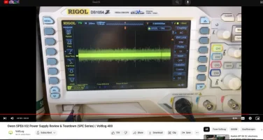

and yes i did take into account the noise levels that some of the reviews mentioned,.
and that even the User guide mentions filter caps to get the rated specs. . . which is well cheeky IMHO!!
But, . the unit suits my needs, (100mV pk-pk ripple - but its a PWM PSU so some noise is expected and has no effect when powering 12v/24v/48v kit)
OWON vid:
getting back to your question. . .
its just arrived today . . so its running some 12v Victron kit sitting next to me on the bench.
ill wait till i get the epoxy board before i take it out and about.
once that fitted, ill get it out to the solar shed,
ill get it on the 50v domestic solar stuff.
and it will be great for testing solar PV for MPPTS`s and the like . . . 0-60V @ 300w max.
most 12v MPPTs are now starting to increase the VOC from 25v to 50V - which is great to see . . . the new Renogy DC50S has 50V VOC - so will be good to test that.
50v @ 6A @300w
Not 60v parsay.
But 54v/55v . . . For the domestic solar stuff...... For waking up discharged batteries..... Enough for the BMS to wake and start charging.

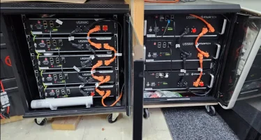

You are aware that US2000 it’s a 15s and the US5000 it’s a 16S, probably you know already, they are not to be in the same system.
