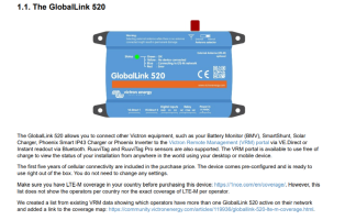

i have the BMV712 + Temp sensor, but atm the 12/12/50 is too new and the FW is not ready for the full VE Smart integration.
but im swapping that all out for a IP65 Smart shunt,
and swapping the CERBO GX out for a GLOBAL 520 . . . so watch this space.

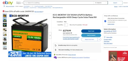

TBF . . .
none of the above really matters of you have a modern Lifepo4 battery that has LOW TEMP CHARGE protection.
which nearly all now have apart from the cheapies, ie ECO-Worthy. Chinese non brands.
and the old batteries from a few years ago like the TN mentioned above.
just check the battery spec.
but note:
ALL will say TEMP RANGE 0-60c for charging and -20-60c for discharging. (but this dosent mean they have low temp protection)
the important thing is to look through the specs to see its its states low temp protection.
its no a standard feature on most lifepo4s since the last year or two.

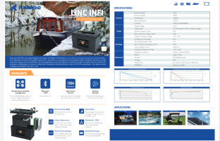

just get a HEATED Lifepo4 - they are awesome and can be charged down to -20c
i have the Poweroad and Fogstar heated, had the Renogy as well.
