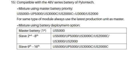

You are aware that US2000 it’s a 15s and the US5000 it’s a 16S, probably you know already, they are not to be in the same system.

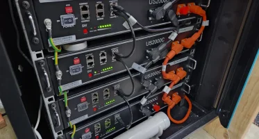

we run Pylontech US2000C + US5000 - both 48v units and approved to work with each other. - we have 8 in a stack (26.4kwh)
( but i think the older 2000 EXTRA units are different )
Pylontech show the compatibility list as including US5000, US2000c, US2000 - but ask for the latest FW version and US5000 to be the master - which ours is, and the Us2000c units down stream.

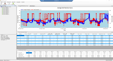

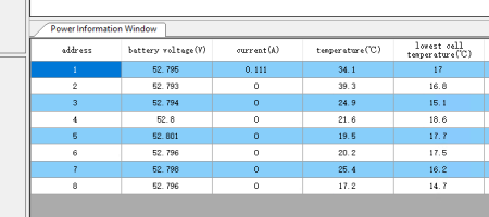

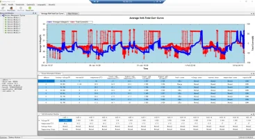

we also run "Battery View" SW to keep an eye on things. . ( here 100% soc @ 51.1v)

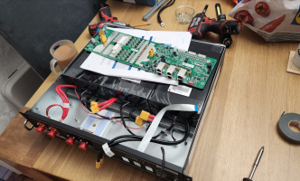

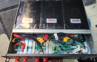

and have already had a US2000c open for a BMS replacement. - which was fun.

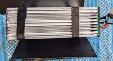

3 cell packs in these. (51v 100% soc - so 17v each pack - (10cells 3.6v each, so - 5s2p i think)

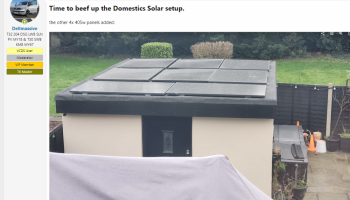

weve started to add in the Domestic PV install stuff.
