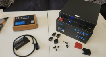

FOGSTAR 230ah Seatbase with HEATER &
Balancer
