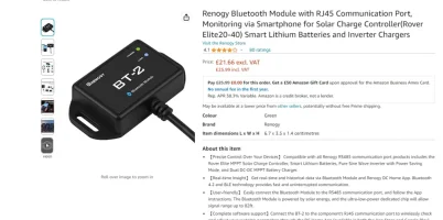

@Dellmassive . Thank you - Just realised that I didn't include the link to the bluetooth module. Is this it ( Although I couldnt find it on Amazon)?

with the BT2 adapter you can program the current limiter. . .

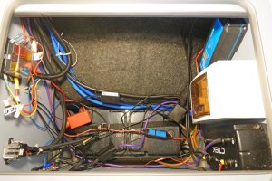

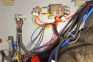

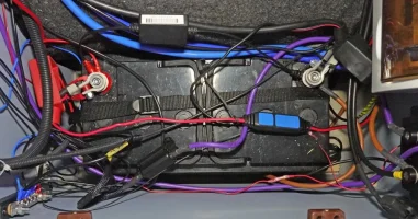

This arrived a short while ago but the Renogy 100Ah Smart Battery that I've also ordered won't be here until around 26 July which gives me a bit of time for more angst over which DC-DC charger to go for (ie. Ctek or Renogy). It's just stopped raining so I'll be going out to take photos of my existing electrical set up shortly and asking for further advice / comment.20230715_091649.webp
Further to my earlier posts, see below the promised photos of my current electrical set up. I've measured the available space and it's clear that the Renogy DC-DC charger which is a fair bit bigger than the Ctek will simply not fit into the space available at the moment. I reckon it would fit if both the the Victron Bluesmart and C-Pak Consumer Unit were moved to the left but it would still be very tight (and also a much more complicated job for me anyway!). As mentioned before, I've read up on various posts on here about what are seen as the shortcomings with the Ctek D250SE with lithium batteries (special thanks to @Dellmassive for his usual expertise) and from what I understand with my limited electrical knowledge, it seems that the main problem is that it does not always manage to charge a lithium batter to 100% but often leaves it at 75% or thereabouts. To my admittedly simple brain, that still sounds like it would deliver more power overall than an AGM equivalent and also have thew advantage of a much longer life. As I said before, I've got the Renogy Smart 100Ah and Renogy BT2 bluetooth module ordered (BT2 already arrived) and now have to decide whether I take the to me much more complicated route of moving all the stuff around to accommodate the Renogy or the very simple approach of a straight swap of the Ctek D25SE for the currently fitted SA version. I've included pictures of the of the 12V side and starter battery for completeness. Note the uplugged cable on the 12V side is for the tap pump which is not used, the fuse on the live solar panel cable is 15A and the small black thing to the left of the 12V fuses is the fuse unit for the Autoterm heater (but I doubt any are relevant).
View attachment 205859View attachment 205860View attachment 205861View attachment 205862View attachment 205863

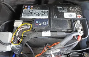

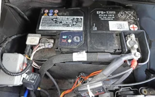

those trailer NEGS are incorrectly installed:
they need moving over to chassis ground. . . . light bracket possibly?
they are bypassing the vans power shunt.

The wiring for mine is actually the same as in that picture but I've never really noticed anything untoward happening. What are the implications of leaving it as is please? Alternatively, would it be OK to just move the wires to connect to the earth point on the bodywork just to the right of the battery? I think the cables would need to be extended though and if so, should I join them with proper crimped connectors or would using Wagos be OK? Thank you
the Trailer kit power is by-passing the van power system - so it wont detect any power draw from the towing electics or caravan.
if you dont tow all the time you wont notice much difference.
but those cables should be on chassis ground.
(if you had any towing gear hooked up you would end up with a flat starter battery)
