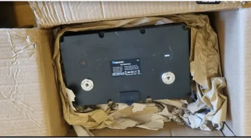

I ordered these off Fleebay. The posts fit the thread on the Renogy 100ah LiFePo4 battery I've just recieved.
Yeah I bought some of them 1st but they didn’t fit the Renogy battery I was supplied with!
They are the ‘normal’ battery thread pitch which you’d expect to fit, but didn’t.
It seems not ‘all’ Renogy battery terminals are the same
Just measuring with verniers to check but looks like my threads are the size stated in the manual for the battery. M8 x 1.25 x 15mm (M8 course)
Wonder if you've got M8 x 1.0 x 15mm (M8 fine).
@Dieseldonkey
My battery’s threads are def m8 x 1.0 & fit.
The std posts I got off eBay & 12Volt planet were coarser 1.25mm thread & didn’t fit.
L to R
eBay post M8x1.25, cap head M8 supplied with 12Volt planet post M8x1.25, M8 x1.0 used in the 12Volt planet post that fits, Renogy hex head M8 x1.0mm sat in 12Voltplanet post to hold it up & still

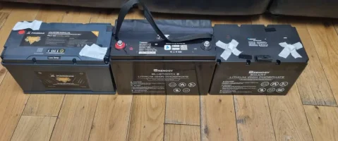

@Ayjay

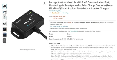

renogy smart come in two versions, standard and heated. - you need to the BT2 Bluetooth module for them to work with the APP.
you can use the standard version in the UK, Heated is only necessary if you say in the Alps etc with constant extreme temps.
see mine here:
standard - Lithium LifePo4 12v Batteries - Time For An Upgrade?
heated - Low temperature lithium battery

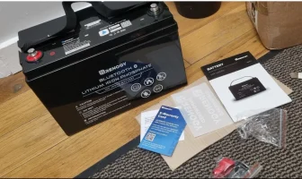

the renogy BT version has built in BT,
its a larger case
it has different cell tech and quotes lass charge cycles.
see mine:
BT version - Lithium LifePo4 12v Batteries - Time For An Upgrade?
I've had all three and they are all very good.

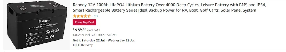

i would recommend the standard 100ah Smart version with the BT2 module
and BT2m module for the APP.
you can also go direct to Renogy and use a discount code:
