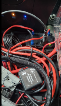

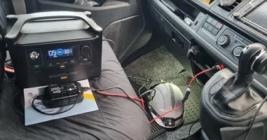

one of the tests i done over Xmas was the old - Charging the starter battery with a Mobile EHU battey pack trick,
which you can see over here --> [Guide] Battery Maintainer (for Starter battery) -- How I Done It --
during this test i disconnected my "Ablemail starter battery maintainer" - [Guide] Battery Maintainer (for Starter battery) -- How I Done It --
which had the effect of dropping the load on my Leisure Battery ( LB ) to a very low current.

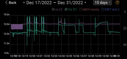

here is the 15day BM2 voltage logger plot . . . which shows the VA graph which is the LB.
so what now? -- what do i do,
i call this BMS drift or SOC drift, and as you can see relates to a drft in SOC from what the internal battery BMS will tell you and what is actually happening in the battery.
the drift will get bigger the longer the battery is left in this state . . . .
infact you can easily drain the battery completely flat like this (which i have done before).
the battery will show its fully charged . . . untill the voltage starts dropping off, which may cause trhe BMS to trigger some other Voltage related SOC charge reading.
but ultimately you will end up with a flat battery even though it shows full, or 50%, or whatever.
