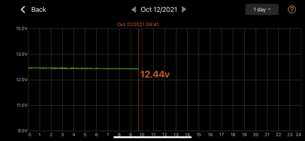

I have my BM2 connected to it and in less than 24 hours its dropped from 100% charged to 70% (12.73V to 12.43) There is only the BM2 attached to the battery noting else! Is my leisure battery ruined?

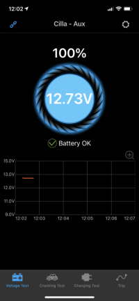

Some pictures from the BM2:
Battery fully charged yesterday at 12:02

This morning however its down to 70%....
Its just sat on the bench in the garage not too cold...
A steady decline....

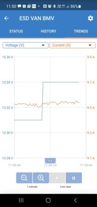

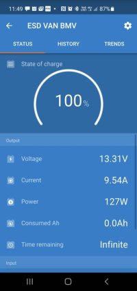

This picture shows a proper flat leisure battery - the Victron Battery Protect didnt do anything!

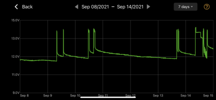

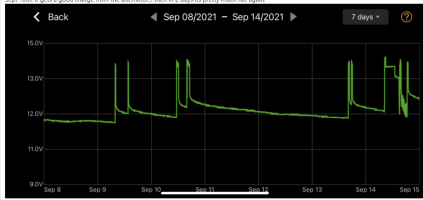

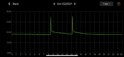

Finally this is a typical usage week of my van:
Sept 10th, it gets a good charge from the alternator... then in 2 days its pretty much flat again.
