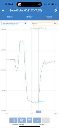

I noticed when I went to camp in December all power was off. Checking on my Victron app it showed the voltage had dropped to 11.5v.
I charged it using a battery conditioner and the battery will charge to 12.8-12.9v however it doesn’t seem to hold its charge very well.

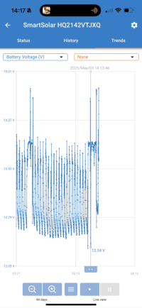

The history in the Victron app shows it constantly cycling with the solar charging from 70-100% the below is over last 40 days.
I went camping on the weekend and the van was on leisure battery with the fridge and an external cooler running it didn’t drop below 70% but was only for a few hours this was with the solar panel giving it a boost!
Question is will it hold? I have two days camping at the end of the month off grid. What’s the best way to check/confirm? I tried getting a garage to do a battery test but they couldn’t with the solar panel hooked up.
