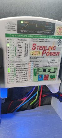

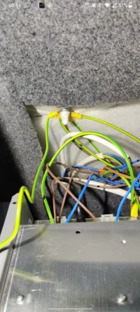

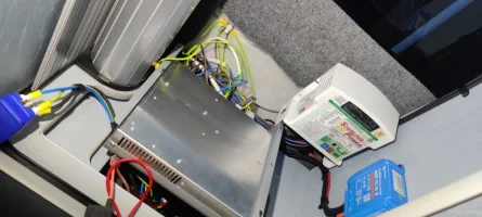

There's no need to be alarmed just yet. After all it's beein working without incident since you've had the van. It depends what the Sagent is using the blue and brown for. I suspect they're monitoring wires and if so maybe that's fine if not exactly professional but if the Sargent is using them for load then the wire gauge is inadequate.I will have a proper look when I'm back, I hate it when someone is alarmed by how it's connected, as I didn't do it, so you 'trust' it to be as it should. Looking at the van it looks like these extra wires come directly from the Sargent unit, but looking through the manual for the Sargent unit I cannot imagine/think why it should be? Unless this is how the Sargent is connected to the vehicles starter battery possibly?
I'm the kinda guy that will potentially take this all out when I get home and redo it correctly but also don't want to be doing something for the sake of it, if it's not right, it's wrong.
Thanks all for your advice so far.
I guess looking at the Sargent manual and the pins those wires are connected to will confirm monitor or load.
