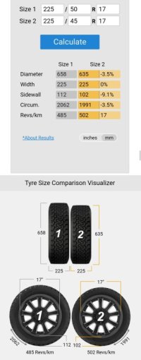

Only 1.4% in overall diameter difference,front(265/40R20) and rear(275/40R20)

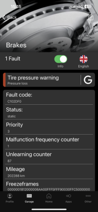

I did a test with a diffrent tyre profile on a rear axle of my Sharan 7N(PQ35).
Approximately every 20km my TPMS was indicating a fault and I had to reset it over and over.
I am pretty sure T6 MK100 is going to behave the same(happy to be proved wrong).
so I guess within system limits/tolerance.
That is how it works. It monitors wheel speed from the ABS sensors. If a difference between wheel speeds is detected, it presumes that is due to the tyre rolling radius changing, ie a deflating tyre, and activates the warning.I guess it logs each individual wheel rotation v speed and pings when one changes. We shall see, but hopefully not.
