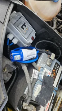

Hi there! Appreciate your post was a few years back but I'm about to put a CU under the bonnet on my T6. How did you secure yours in the end? I can see the "foot" that you referred to, but not what to fix to it? Many thanks!
I cut the plastic foot off.
In its place is a steel foot welded to the upright angle iron you saw in the photo
Mine is a full camper conversion done by Tonke in the Netherlands. The hookup is under the bonnet while the CU is at back of the van in a small cupboard where the Victron charger and the (camper) fuses are as well.
The CU is outside the pic (sorry) just below the fusebox. (the cut wires are unused > pre-installed for future options/upgrades)

Think i have got my choices down to these two, will they work under the bonnet?
The Rayne one is smaller, but has no reverse polarity light which seems useful, but is 6A/16A Type A. The 12 Volt Planet one is 10A/6A but Type C.

If it's gonna go under the bonnet, then you need an external rated one as the dust will get into the switches and stop them functioning properly.
So look at one that's got the front cover.

Thats my question really, as i want it under the bonnet - but it seems people are using much smaller consumer units with 2 x RCBOs? But have not (yet) been able to find one pre-made with that setup
I don't have a main switch.
I have 2 x RCBO's. One feeds into the van for a couple of sockets and the other feeds an outlet that i connect an extension to for in the awning.
I did mine based of all the info in this thread which was super helpful. Did the Wylex Box with BG double pole RCBOs. If you want some more images of how I routed it all, let me know. I used heavy duty velcro to secure bottom and side and hasn't budged!
