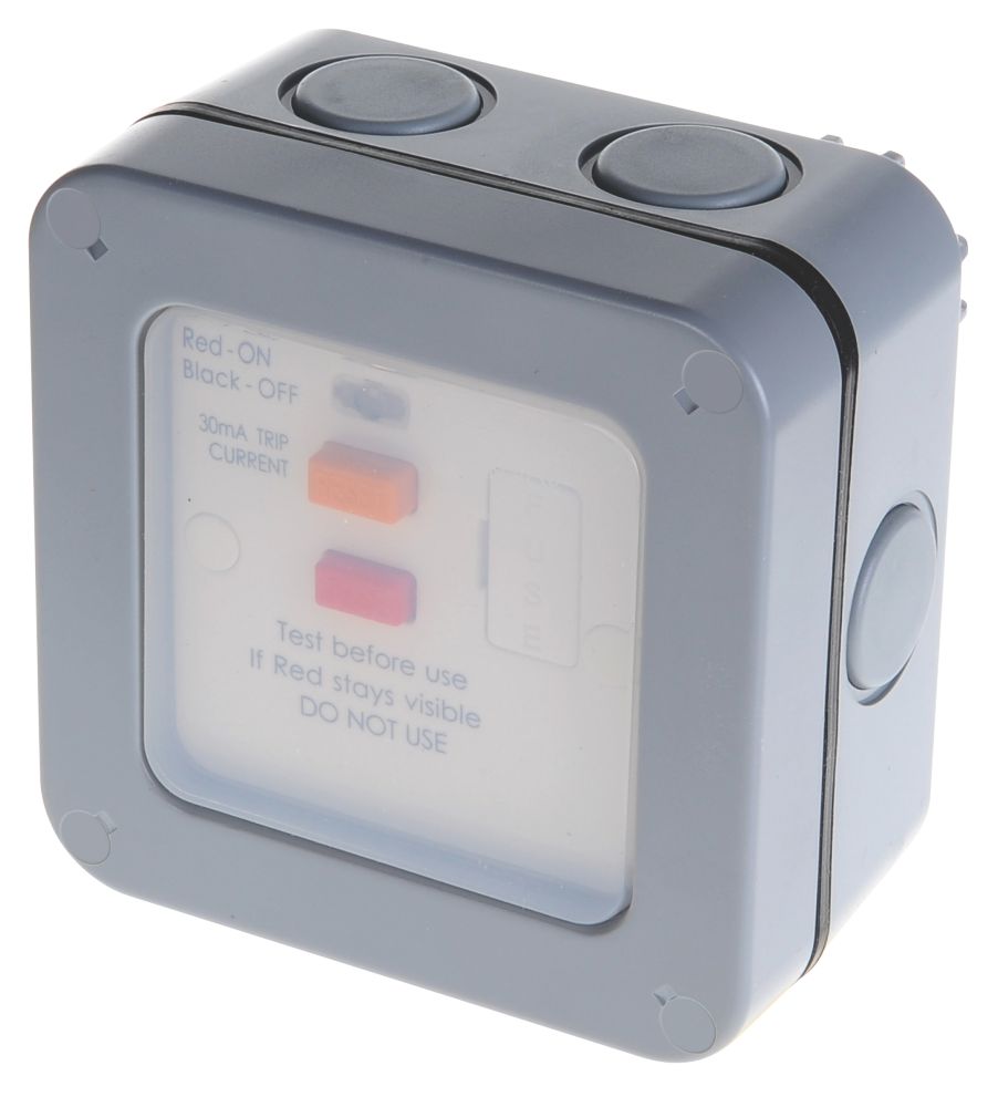

Wondering if this is adequate for the purpose. To be fitted inline at the bonnet end of the EHU cable I'll be routing from under the bonnet to supply my Victron smart charger and onwards to a double wall socket?
www.screwfix.com
Thanks a plenty (whether it's yes or no).
British General IP66 13A Weatherproof Outdoor Switched Passive Fused Spur - Screwfix
Order online at Screwfix.com. 13A. Switched fused connection unit. RCD protection against the risk of electric shocks. Multiple cable entries and high impact resistance. FREE next day delivery available, free collection in 1 minute.

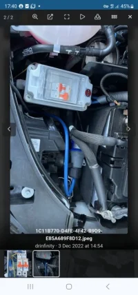

etc, you would be limited to13A. If you did inadvertently blow the fuse, you'd be scrabbling about under the bonnet, in the dark, in the rain. These things never happen during the day when it's sunny & warm. Generally you'd use a 2 or 3 way consumer unit, similar to a garage or shed unit, with an RCD & a couple of MCBs. This would allow you to have a mains socket outlet on one breaker, and an another breaker for ancillaries e.g. a mains charger for the LB.
