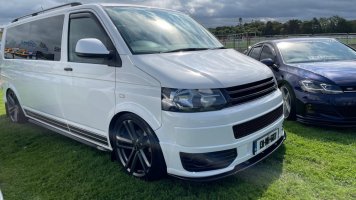

Hi Andy, van looks great. I'm curious though, are you saying you're at full height ? What tyres are you running, 255/35 ?
I have mine (T5.1 T28 camper) at nearly full height and its not that low
Thats a strong look. Looks proper smart that.

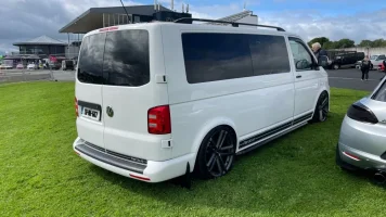

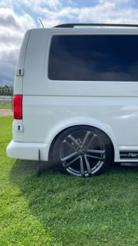

Thanks, I do love my SoLows but found that the original SoLow rear springs were a bit soft for my camper as even at full height they hit the bump stops and the tyres rubbed the top of the inner arches. I did trim the rubber stops some what but didnt want to cut the metal holders. I ended up fitting my original Eibach Low 60mm rear springs with no collar (adjuster delete) and am very happy with the ride and look. I think the picture I posted above was with the adjuster fitted but with no rings. Here's a few from a show I did recently with adjuster delete. When measured it's exactly the same height as it was on the SoLow springs near max height, 355mm.
Hi Ben
Front is at full hight yes
Rears have around 10mm more to raise
Tyres
front 255/35/20
Rears 275/35/20
No rubbing wing screw removed

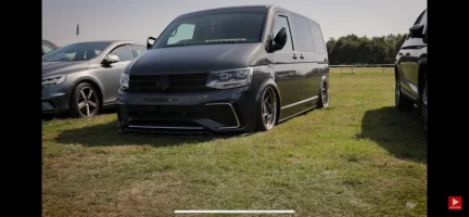

SoLow all the way, swapped out my ABP front and rear Air for SoLow and even swapped out my ABP stealth, so called quiet compressor for one of the SoLow versions which are lighter, smaller and quieter.
One of the biggest bonuses for me is the 24month warranty whereas you only get 12 months warrantly with other Air products.
Now thats beautiful. A lot of work gone in to that front end!! Yes we've tried our compressors side by side, with all the other compressors we've found out there so far. When testing with a DB meter, the Solow SSH compressors are considerable quieter.

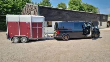

@The Bear78 Great stance, I notice you have a tow-bar, what do you tow? any issues being on SoLow?
See the post above with the caravan. Lowering the van helps when towing, as it bring the hitch down to match the caravan height.
No. No problems towing in general but our horsebox hitch was a little higher than the tow bar. It was quite noticeable how much more weight was on the front wheels of the twin axle trailer.
I've since switched to a different Bilstein coilover which give about a 70mm drop but, this was mainly because of ground clearance issues. Towing to horse events and my recently taken up hobby of trials riding means a lot of trips along rough tracks and through forests and the van was just too low. I've also fitted AT tyres so the van is about 30mm higher than previously which is ideal. The bigger tyres really fill the arches too so it doesn't actually look any higher at first glance.
I can't fault any of the Bilstein products that I've had.
