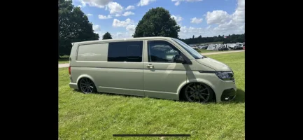

Im running original Solow’s on my T32, think front is on highest setting and back is down a bit. I need to change my tyres as getting a bit of scrubbing on a bumps. Drives really well on them though, much better than my original suspension!

Glad you're please with the set up. The van looks great. As for the scrubbing on bumps, there is a small screw at the top of the wheel arch where the wing joins the arch liner. Have you removed that? This may be a simple fix. You then just pop the plastic liner the other side of the tab the screw was in and fold it up out the way. We'd do this as standard on any low or air install. I hope this helps.

Yeah the screw is out and the tab is folder up. Its just the tyres being 255/45/19 but im going to go to a 245/45/19 to see if that helps.

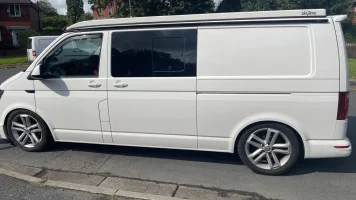

I've currently got the original LOW coil overs set to their highest setting on my camper build. I am very happy with the look however find them a little too soft and dare I say perhaps under dampened which may be due to the weight. Someone else on another recent thread (perhaps the one which prompted this one?) was saying they felt they were a little soft on a camper and had changed the rear springs out.
I've not measured but expect I may be lower than 100mm due to the weight but certainly can't go any lower with 255 45 18 load rated tyres particularly the fronts.
I realise there are other coil overs available that will give a firmer ride but I really don't want to sacrifice the look and almost without exception everyone who has the LOW seems really happy with them.
How do the NSL therefore compare when run at their lowest with the LOW at their highest?
I would go with LOW set high over NSL set low. I hope that make sense. Its a fine balance between looks and comfort but going really low will always have its sacrifices other than going on AiR. What its impossible to do, is factor in every van type into spring and damper development. Empty SWB 102 manual will be very different to a LWB 4motion DSG full camper for example. It would be an interesting experiment to try the NSL rear spring with your current us set. It would all work and fit as they use the same adjust platform.
