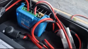

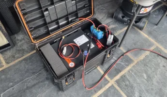

to feed into the Delta 2 i took my Roamer 230 battery box. . . . which has a Victron 100/20 solar mppt squished inside.
see more on that here >> 4173Wh (330Ah) Lithium Battery Box -- How I Done It --

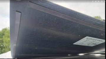

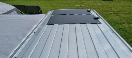

we also took four 100w flexible solar panels. . . that i put on the roof, and held them there with Neodymium magnet hooks. .
the solar panels also had some mag stip on the rear . . .
example two out of four below . . . .
i used MC4 extension cables to link the panels to the MPPT controller . . . which was in the battery box, in the van. . .
the mppt was connected to the roamer battery via fused SB50 Anderson connectors.
and finally the roamer battery was connected to the EF Delta 2 via a fused SB50 Anderson to XT60 link cable.
so this is how it worked.
400w panels
to victron mppt
to charge the roamer 230ah storage battery, ( up to 20A/400w)(3000wh capacity)
to then slow charge the Delta 2 (100w slow charge ) (1024wh capacity)
the system worked well, we never run out of power.
why not just connect the solar to the Delta 2?
well there is a chance the delta2 would be fully charged by 11am . . . and will a low load draw the rest of the solar for the day would be waisted, .. . .
untill the following morning, when the fridges had drained the Delta 2 back down again. .
there is also a chance that there could be cloud or rain . . . meaning no solar.
so what we done was to use the Roamer SB230 as a storage battery that has three times the storage capacity of the delta,
this battery allows the Delta to slow charge (100w) 24/7 even through the night.
but allow full use of a full days sunlight by charging the storage battery.

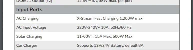

- no, because the Delta2 has only ONE input for solar or 12v car feed. ( so its either or on the delta 2 )
you cant have both.
( there are some slight losses, 1st solar MPPT to DC, then a second dc-dc MPPT in the delta2) ( not measured the losses, but assuming they are minimal)

delta 2 spec below.

Ah I was assuming the bigger packs had both dedicated MPPT inputs and 12v rather than a single combined one. And yes good point about the voltage on the solar string, that's going to be higher on a dedicated charge controller.
For buck/boost converters at lower power that I'm used to (RC models etc) I'd normally guess at about 5% loss but I was intrigued and went for a quick look. Generally the losses mount under higher current or bigger voltage step up difference. CTEK don't publish figures but Victron do for the Orion. Looks like a reasonable estimate for the loss would be around 10%? I'd rate that as enough to be aware of but not enough to worry about.
