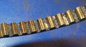

only the oil pump belt was in worst conditions, ready to yield
all the black lines you see are cracks, and i found out what the pieces found in the oil pump strainer were
the belt was crumbling
PLEASE PAY ATTENTION!
about the oil pump belt nothing is written in the user manual as a replacement interval,
the same thing on the workshop manual and on the etka website...
i asked for at the volkswagen reseller, and at the italian importer,
and the reply is the same "the oil pump belt shouldn't be replaced"
now, seeing what I discovered, I did a search and found that several engines at about 400,000 km (about 250000 miles) melt due to the belt breaking
if I hadn't opened the engine,I wouldn't have noticed and in a short time the engine would have broken.
the entire amount (parts and works) is not too much expensive compared to a new engine costs.
