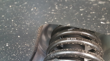

I’ve got a 2017 T30 on standard springs. Since conversion it has been sitting low on the rear end.
I recently ac some T32 shuttle rear springs from a forum member and had them fitted yesterday.
Unfortunately the stance still appears similar to before.
Is this to be expected? I was hoping the T32 springs would even things out.
I’ve read lots of info regarding the colour markings on springs…… there seems to be no definite answer on which colours denote weight rating.
The ones I had fitted yesterday only have 1 yellow mark on them, but I was told they were removed from a T32.

The rear springs removed had 4 yellow paint marks from a T30 and the ones fitted have 1 yellow mark supposedly from a T32 ¯\_(ツ)_/¯
@WeaversT6 T32 rear springs have 3x Grey marks. If you have T32 rear springs the additional load will not cause sag.

I’ve bought some springs from a forum member who assures me they are from a T32 (but only have 1 yellow paint mark). I paid to have these fitted yesterday. Does this mean I’ve been lied to?
No idea, all I can tell you is you don’t have T32 springs. I have a T32 outside with 3x grey and a set of spare T32 springs with 3x grey.

Also, there are some ‘T32’ springs out there that have only 2 grey marks, what does that indicate?
FWIW....my 2019 T28 Pv is showing
grey and green to the fronts and 1x green on the rears, 1550 load rating (1 and 2)

I have 2 pairs of T32 springs in my garage. The diameter of the actual metal making up the spring is clearly different between the 2 pairs. As the table I pulled together above demonstrates, there is no single thing called a T32 rear spring - there are many variations, to cope with the many weight variations.
