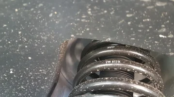

fwiw . . . there are my factory rear spring set MY18 PV

The rear springs removed had 4 yellow paint marks from a T30 and the ones fitted have 1 yellow mark supposedly from a T32 ‍♂️
@WeaversT6 T32 rear springs have 3x Grey marks. If you have T32 rear springs the additional load will not cause sag.

I’ve bought some springs from a forum member who assures me they are from a T32 (but only have 1 yellow paint mark). I paid to have these fitted yesterday. Does this mean I’ve been lied to?

No idea, all I can tell you is you don’t have T32 springs. I have a T32 outside with 3x grey and a set of spare T32 springs with 3x grey.

Also, there are some ‘T32’ springs out there that have only 2 grey marks, what does that indicate?
FWIW....my 2019 T28 Pv is showing
grey and green to the fronts and 1x green on the rears, 1550 load rating (1 and 2)

I have 2 pairs of T32 springs in my garage. The diameter of the actual metal making up the spring is clearly different between the 2 pairs. As the table I pulled together above demonstrates, there is no single thing called a T32 rear spring - there are many variations, to cope with the many weight variations.
