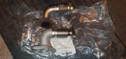

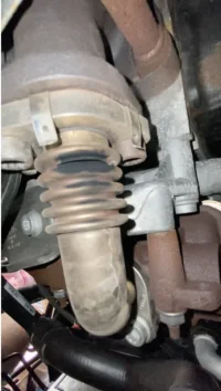

Just done mine (2018 DSG, 40500 miles). There was a choice of two from TPS, a short one and a longer one depending on the manifold. Mine was the short one like the photos above, but the new one now has more/tighter packed bellows, and costs £88.61. Wouldn't have been too bad to change if I hadn't drop two bolts (and if you can't find them they will be jst in front of the DSG filter, and aren't magnetic).

I'm not with any of my paperwork at the moment, but I think it just goes on your Reg number, although I don't know if there are any variants.
Edit:
Just found this picture I sent to another member who had my spare pipe, The part number is next to the word 'Pipe' if you can zoom in and see it.

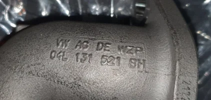

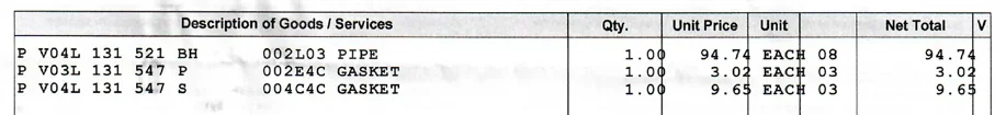

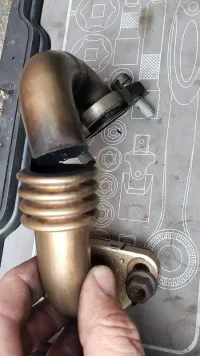

Okay, it is confirmed, my pipe also cracked.
My original pipe part number was 04L131521H
and I have replaced it with 04L131521BH

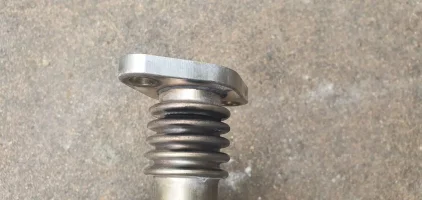

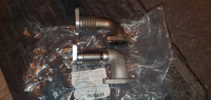

The difference can be seen below.
Old one is made out of formed stainless steel and the new one is SS and machined cast.
Also there is huge difference in the actual flexibility of the flex section.
Additionally new pipe 04L131521BH is approximately 50% heavier than the old one!
Simple job but awkward access and the fact that I dropped my bolts 3 times turned into few hours! :eek:
Two bolts on the exhaust manifold side are non magnetic so if you drop any of them you won't lift it with a magnet, disaster! o_O

Ordered part from TPS, be here tomorrow and all of £20 with vat, so ordered 2 just in case this starts to become a common problem.
It looks like an easy 4 bolt job, but I will let you know tomorrow.

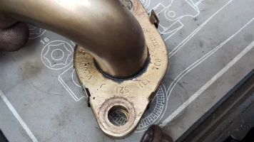

I had the small egr pipe on the back of engine replaced about 300 miles ago because it had a crack in it
just drive it from Kent to Bournemouth
as I come of motorway sounded like exhaust manifold fell off
I took to kiwi fit they advised me egr pipe at back of egr that bolts to manifold had broke it had actually fallen out the centre of the pipe
Has anyone had this before we’re it keeps braking pipes or why it would even happen

Not heard of this happening before. Was it the old style pressed steel type pipe with 5 corrugations or the cast one with more corrugations?
I noticed my old EGR cooler was shaking a bit. I've got a video I'll try and upload. Basically if I touched the rubber pipe near the top I could make the vibrating noise go away. When it had all cooled down I noticed that two of the bolts were missing that hold the cooler to the engine. These:
However... Replacing them got rid of one noise at idle but I still have the other noise that sounded like a cracked manifold or such. And was of course the EGR pipe.

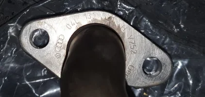

I then ordered the new part that this thread references and got the old one off last night to find mine is actually this part number...
03l131521j
Anyway the point is maybe one thing lead the other. So those who have had repeated EGR pipe failures please check to see all your mounting bolts are present.
I'm going to put spring washers on them and maybe a dab of medium strength threadlock.
Oh and if you're wondering they are M6. One side is from memory 28mm long and the other 38mm. But please check that. Deffo M6 though.
