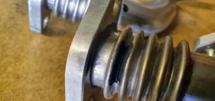

If by EGR Hose, you mean the metal flexi-hose on the back of the EGR like mine in the picture, then this is a very common problem. I'm on my 3rd, but I have seen that they've modified the new batch, so you should be ok now.

Put picture up of cracked pipe

Mate, these pipes are under £20 with the metal gaskets from TPS. I'm on my 3rd and as mentioned, it's a very common problem. They seem to crack around every 50k on my 2017 204.
The improved design has more fins on the expanding part, but there is no way it should of cost £146. I'd be popping back and asking why a previous part that was less than £20 is now £146, when it's still the same part, albeit slightly improved. (apparently)
