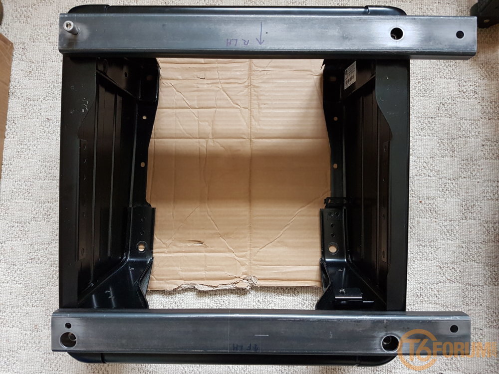

With that size of box section i guess they'll probably end up the same height as the original van seats.

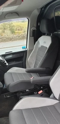

How were the armrests to fit, I've yet to do that to my R seats?

Armrests werent actually too bad i bought the kernow transporters kit and cut and redrilled the brackets to suit existing holes in the golf seat frame. Im abit crap with taking pics and documenting but i used the holes that the lumber support handle fixes to, thats now gone along with the air bags.
The box section is now carpetted too and im hoping to install tomorrow, i like to sit quite high up compared to others in my van plus this way i can always come down abit hence the big box section.

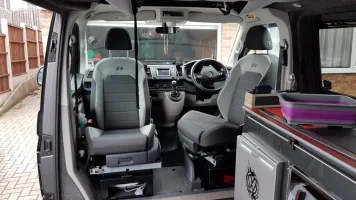

Looks ace. I've got scirocco seats in mine, i want to mount on a swivel base, does a simple rail shorten clear the B pillar trim?
I dont see why not, not sure how much you could get away with removing though without it messing with movement of the seat
Not sure how much you'd need to shorten by if at all?
Just watch if you do shorten the rails you don't remove any rearward travel stops!
Small up date on my own seats while im here 50mm box is abit high for anyone looking to do the same, i may redo my own with 50x25 and see what adjustment that gives me. 50mm sits lower than the original seat but at the golfs seats lowest adjustment its still a little too high up, sometimes feels bang on but sometimes a bit much
IIRC, that's why I chose to use 50 × 25mm section. :thumbsup:
After some crude seat height measurements, and noting the more reclined angle of the car seat base, that size seemed a good option for mine.
Agreed i should have followed suit first time round, ill give it a go if come across some box section that size see how it feels. Apart from that love the R seats just need to sell the originals too

Thanks, chopped about 60mm at 45 degrees off the back of the rail and it just misses the B pillar trim, all works a treat, rear stop preserved.
Ideal solution! :thumbsup:
Out of interest, which brand of swivels are you using with the Scirocco seats?

Amazing work dude, what armrests did you use? and how easy was it to strip the seats to get the brackets in place?
cheers, armrests are from kernow transporters, i used the older t5 brackets, cut and drilled to match holes that were already in the golf r seats where the lumbar support was fitted. there are matching holes on both sides of both seats that i bolted to then its just cutting the foam and fabric. removing lumbar support and airbags wasnt too bad just careful putting everything back nicely. hardest part id say was making the brackets work but you'll see what i mean about the holes where lumbar support was fitted if you take a seat apart. i should have done piccys but tend to get abit too into it and forget about documenting
