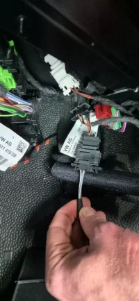

I'm going to say it should be plug and play. I have just retrofitted oem seat heating to my single drivers and double passenger bench and can confirm they both have the same plug connector. One per seat.
The only difference is that the seat heating pads on the bench will be slightly wider but again there is only one connector to plug into for this.
However, im not sure if the single seat base will cover the opening in the rubber floor for cable entry. On the bench seat this is more situated under the seat base closest to the drivers seat.
Hope this helps.
Pic of passenger and driver seat connectors. Both identical 20260403_162728.webp20260403_161323.webp
