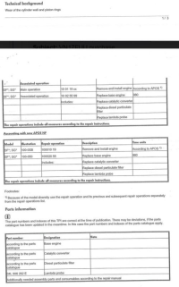

the VW OEM repair is :
new Bi-Turbo,
new CAT,
new DPF,
new Lamda probe.
2# the Bore/Piston wear, that the TPI covers (TPI - 2061290/6) - which the VW tech says can be witnessed with wet oil one or more cylinders, and not all four as id assumed, he said the chances were that one cylinder will be leaking oil, showing as wet, where the other will show dry, he also said that a compression test will show the weak cylinder, the wet oil and carbon deposit will also clog the injector head, which leads to a miss-fire on that cylinder. ( basically what i had)
the TPI states a guided fault finding, which calls for the oil to be drained and weighed. then replaced, then 500 odd miles to be driven, then the oil to be drained and weighed again.
if the engine shows that the oil usage is more that 0.5L per 1000km then its a fail and repair required.

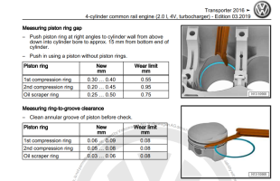

the further investigation required is to compression test the cylinders (25-32bar for a new engine - 18bar wear limit)
borescope the cylinder walls looking for worn walls, and possibly measuring the cylinder diameters to so excessive wear.
the repair is :
new Long Block Engine ( Block, pistons, crank, head, cams etc )(but not accessories like EGR, Turbo etc)
new CAT,
new DPF,
new Lamda probe.
TPI - 2061290/6
CXEB excessive oil consumption . . over 0.5L per 1000km
New long block engine from VW roughly priced at 12-15k for parts, then 5k labour according to the tech that done the recovery on our van.

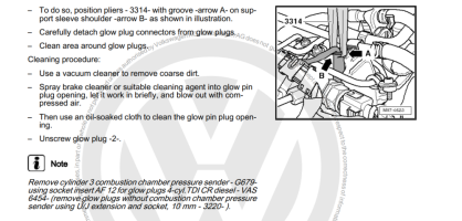

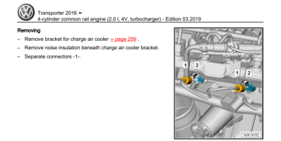

getting to glowplugs. . . .
