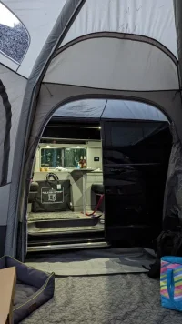

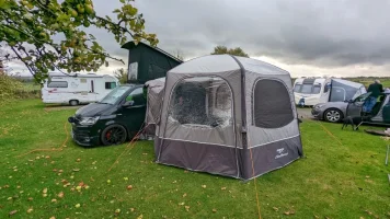

We opted for the Vango Airbeam Hexaway Low. Not a massive footprint, but big enough for two people and two whippets. Nice and tall, so no crouching ...and air beams, so easy to erect.
We've bought the groundsheet, internal footprint, and carpet. All need to be the genuine items due to the hex shape, but none of them are crazy expensive IMO. I like the Vango sky hooks...make hanging lights nice and easy.
One thing my wife really wanted with an awning was light. This thing has three large 'windows' (and a couple of mesh panels for when it's warm enough) but also small roof lights too. Nice and light...
Lovely piece of kit, but I've nothing to compare it to ...my first one (new to it, remember? )
The ONLY thing I dislike about it is that the doors have hooks/catches about every foot or so...and the zips snag on every one of them. Annoys the snot out of me every time I want to open/close a door. Other than that, highly recommended.

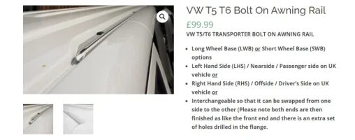

VW T5/T6 TRANSPORTER BOLT ON AWNING RAIL
This fantastic awning rail is a single piece of aluminium which is discreet – in fact out of sight – yet smart looking with chamfered ends to stop your awning snagging when feeding it in.
- Long Wheel Base (LWB) or Short Wheel Base (SWB) options
- Left Hand Side (LHS) / Nearside / Passenger side on UK vehicle or
- Right Hand Side (RHS) / Offside / Driver’s Side on UK vehicle or
- Interchangeable so that it can be swapped from one side to the other (Please note both ends are then finished as like the front end and there is an extra set of holes drilled in the flange.
Simply bolted on to the T5/T6 gutter using the existing bolt holes in only a few minutes – there is no glue or drilling and it can be removed easily too if desired.
The best, most discreet and easiest to use awning rail on the market which will give the ultimate in awning attachment. Quick and easy to use whilst holding your awning onto your van in the most secure and weatherproof way possible.

VW T5 T6 Bolt On Awning Rail – Camper Essentials
Camper Essentials offers the best Volkswagen VW T5 T6 Bolt On Awning Rail. Simply bolt on in minutes. The easiest and most secure awning attachment. UK madecamperessentials.co.uk

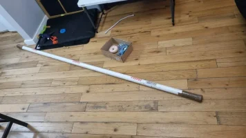

The vans LWB, so we have five fixing bolts to remove.
these are the roof rack protection stickers . . . ill leave them there for now. .
the OEM bolts are removed with a 5mm Alen key.

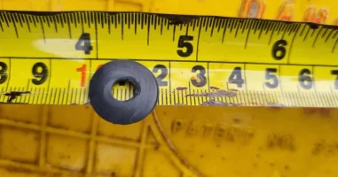

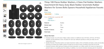

we need to take off the rubber washers as these need to be re- fitted under the new rail - for water proofing.
the original rubber washers looked a bit knackerd. . so ill measure up for some new ones. . .

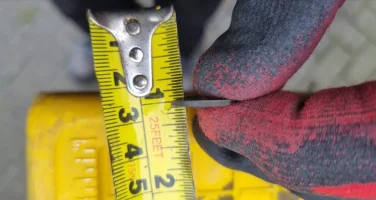

about 17mm diam with a 5mm hole.
and about 2mm thick. . .
fitting is super simple. . .
place the OEM washers over the bolt holes,
then place rail on-top,
then use new extras washers that were supplied and fit bolt.
doing them all loosley before nipping up.
nice . . .

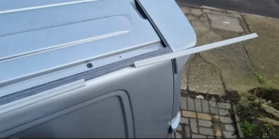

next up was to test fit the kador strip . . . . .
i found it was easier to fit from the front of the van as the spoiler got in the way a bit. .
front the front was much easier. . .
the Fig-8 strips were next, and slid on easy.
View attachment 192226View attachment 192227
with the kador and strips tight to the rear we have this left over at the front. . . . . .
very happy with that. . . .
no i just have to hope the KHYAM side awning will fit on the FIG-8 strips ok.
new washers:
View attachment 192230View attachment 192231
