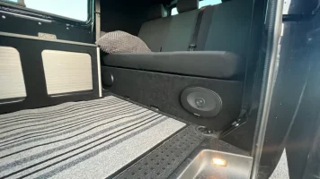

the Kombi seat sockets are raised off the floor.
so id imagine any false floor would need cut-outs or recesses to accomadate the sockets.
maybe a job for @Eli to CNC me out a false floor out of the same stuff the Ovano is made from?
so maybe a CNC Sheet - green,
with recesses for the sockets - red.
Yeah thats what I was thinking. Either recessed or some battons attached to bottom that go between the brackets inbetween, judging by the amount they stick up a combo of the two.

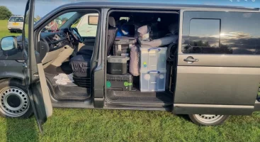

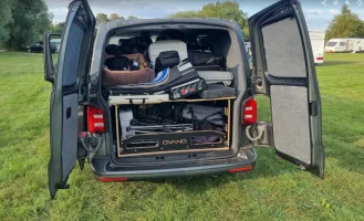

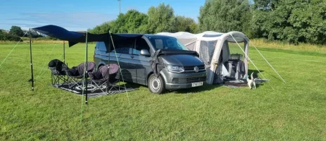

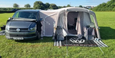

First weekend out in the van. . . . . . . .

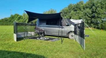

the idea was to take both setups (option#2-railsail and option#3-full awning)
we had both C-rails fitted, so one setup at each side to test what's what . . .
packing worked out well,
we realised that we need to remove all of the second row seats to get enough room to get the gear we needed to site.
on the slider side we had the Vango Rhone drive away - for sale - For Sale - Vango Rhone Air TC - drive away awning bundle
and on the other side we had the railsail, windbreaks, floor matt, camp chairs. . . .
the double setup was pretty awesome tbh . . .
tons of room . . .

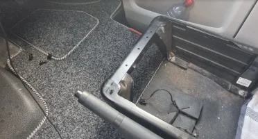

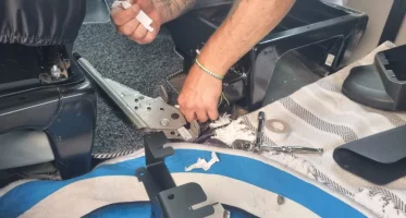

first job once all the gear was out was to fit the drivers swivel plates,
but before that the handbrake lowering kit needed to be done,
seat out with four fixings . . .
Handbrake cowling removed. . . then two fixings. . .
things got a bit busy after that pic,
but the operation was the same for the drivers swivel. . . .
the kit went in well,
but the handbrake cables needs more adjustment.
we adjusted the nut up top. . . but there is still too much slop on the cable.
so i might need to go to the second adjuster under the van . . . .

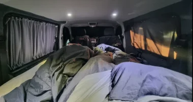

Curtains . . . . part2
after a slight procurement issue by the chief advisor, . . . . . .
we now had the correct drivers side bling from THQ. . . .
being a lot more cautious this time with the pre drilled fixing points and screws, we had the second blind in, in no time. . .
they done a fair job, going from this (with a temp measure grey table cloth over the side window rhs)
to this. . .
the curtains still wont slide fully each way. . .
so ill be looking at tacking the screws back out one at a time, and slightly counter sinking the pilot hole to allow the screws to sit lower.
allowing the slide clips more space in the rail. . .

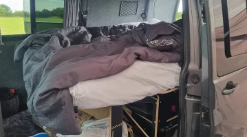

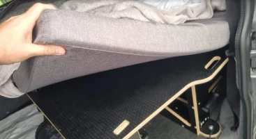

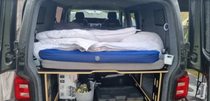

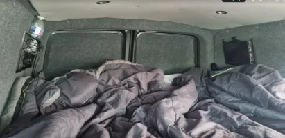

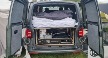

The Bed . . . . . . . .
this was the setup. . . .
the 40winks mattress, on the Ovano bed board. . . . . .
with a double fleese throw ontop, then a double fitted sheet ontop of that. . .
then one of our double camping sleeping bags opened out spatch-cock chicken style. . .
looks great right. . . .
well the following morning after the first nights kip . . . . we were both busted.
question mark style.
sore neck, aching back the works. . . .
moaning to the wife, she said the same . . . . so i knew it wasnt just me. . .
new bed i thought. . . so lets try again the second night.
well - the following morning, after that sleep the neck and back ache was double bad. . . . .
this was not working. . .
i think what was happening was that we/I was sinking through the foam mattress and lying on the bed board. . . effectivly the mattress was not taking our weights. .
looking at a few options:
replace the 40winks mattress with an air bed, - would make the bed to high
add a yoga mat under 40 winks - not effective enough,
replace 40winks for a thicker mattress - takes too much space in the van traveling.

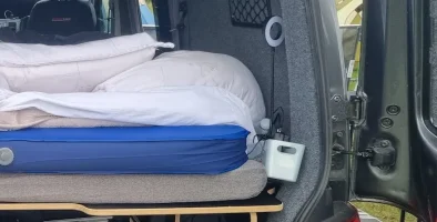

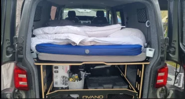

add a SIM (self inflating matress) under/over the 40winks. . . .
so thats what we done. got a SIM.
lucky for us its bank holiday weekend and GO Outdoors had a 15% off deal.
and previously i had this in my basket as a mattress option - but decided it would be too thin for a full mattress.
a quick trip to GO and we was set. . .

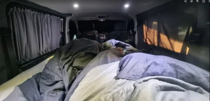

third night luck i thought. . . . or were going home. ( im sure we have all been here at some point)
the revised setup was this. . . . the first night we tried the SIM on top.
and the fourth night we tried the SIM on the bottom. . . .
well i have to say this totally changed everything. . .
one (well two now) of the best nights sleep ever. . . .
adding the SIM meant that we was not squashing through to the hard bed board - causing the back ache.
thats us sorted for now.. . .
but i don't know how i feel about it all . . . the 40winks is £240 odd quid - but didnt work for us?
so we had to add a £150 SIM to make it usable. . .
40winks Not fit for purpose? or are we just two chunky monkeys and too heavy for it?
should they state a weight limit for the mattress?
i don't know.
the thing is . . . . if we sent it back - we would still need a second foam something to add to the SIM.?
but that could be a £99 ikea foam thing . . . . Hmm?
well its worked ok for now,
the 40winks has the carry bag and will be store in the house when not camping.
the Berg` SIM rolls up small to a backpack side bag, so could live in the van for quick over nighters?

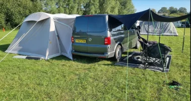

we had both C-rails fitted, so one setup at each side to test whats what . . .
View attachment 211779View attachment 211780

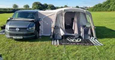

tons of room . . .
I’ve been on the fence about a railsail - we’ve got a Vango tailgate air-awning - but your review has convinced me to get that too.

similar to these . . . . .
View attachment 211829View attachment 211830View attachment 211831
Have you tried the mattress on top of the inflatable? We found the panda on top of the Vango sim so much more comfortable.
Great work again, Lee.
And the thermal screen has been on my watch list for too long..
One question though: does it fold down much, if at all?
the railsail is awesome. . .
I've had my eye on them for ages. . .
@Deaky and @Fish have been rocking them for ages - so I've been watching from afar.
good quality and worth the price.
I've added guy lines as the rail sail comes with nothing.
I've also added 4x king poles.
and i added 4x thin flagpole stakes. - that I've taped the king poles too.
this stops:
1# the wind blowing the sail upwards and the kingpoles falling over . . .
and
2# stops the dog from knocking the king poles flying when the dog lead get wrapped around them.
my shopping list was:
1x railsail (6mm C-Rail / LHS Version) - Kiravans Railsail Awning - The Versatile Multi-pointed, Heavy-duty Campervan Shelter
4x kingpole set from Stitches + Steel - Black Aluminium Extension Awning Pole
alternative: https://amzn.to/3qW6dUc
4x king pole tops - 4x Outdoor Camping Canopy Tent Pole Insulation Caps, Awning Rod Support Bar | eBay
6x guy line set: https://amzn.to/45RMHHd
4x flagpole stakes - Flag Pole Ground Stake Spike 1M (Support Anchor Post Windsock) 600988510593 | eBay
View attachment 211823View attachment 211824
