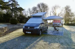

I’ve arrived a bit late in this thread but perhaps I can offer a slightly different angle on the awning/height issue. My van is a full camper conversion but used as a daily driver too. My first priority was height restrictions so with a pop top I’ve not found any less than 2mts that I wouldn’t try. However I did want an awning and realised a roll out type would add up to four inches of height. Restricting my daily driving/shopping. It’s also parked in the road in central London so I try to keep it as stealth as possible and an awning rail would be a bit of a giveaway as well as being very nickable. So my compromise was a Reimo multi rail which is not only a massive gutter, so necessary on a T6 but the slot underneath is perfect for a caravan type of fixing. I have a Palm Beach that slots in very easily and I’ve even been able to drive away from it and return a few times with someone guiding it in. With the sides fitted it makes a very useful room. So with my tailgate awning up too I have an embarrassment of space for bikes, bits and visitors. I believe the Palm Beach is no longer around but Im sure there’s still loads of similar type awnings around. I guess all this means the name of the game is adapt to your own particular needs. See you at Brands.
I'm quite a fan of the simple tarp style awnings that attach into a multirail. If you combine those with 4 variable height poles it's incredibly flexible, you can make a simple sun shade, a kind of tunnel effect for bad weather and a huge variety of custom angle effects for specific wind/rain directions. Granted, it's not quite as quick as pulling out a wind-out awning but it shouldn't take more than a few minutes to setup with a bit of practice.

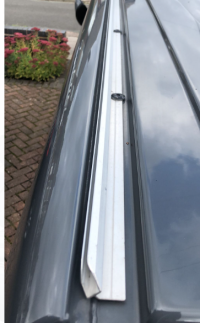

Here you go Lee, awning cassette removed
YES CHRIS. . . . !!!!
Thats what im talking about . . .
Thats what i was hoping for . . . . . the Rail with 100% fully detachable cassette wind out awning.
now. . . .
i know yours is OEM Cali etc etc .

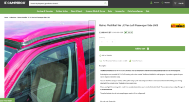

so the question now is - can i do this with a Reimo multi rail?
eg:
Description
The Reimo Multi-Rail Awning Rail is a high quality multi rail type awning rail for long-wheel-base VW T4 T5 T6 Transporter vans. The Reimo Multi-Rail Awning Rail fits just above the top of the door line at the edge of the roof of a VW T4, T5 or T6.
This multi-rail has two connection options for drive-away awnings and sun canopies, a C-profile channel for 6mm Kador and a gutter for pole and clamp kits. The gutter also deflects rainwater run-off away from the side of a van.
This Reimo Multi-Rail is for the left-hand side of long wheel-base vans and is supplied with both Reimo end profile spoilers.
Fitting
The main anodised aluminium part of the rail is fitted using the supplied self-tapping screws combined with an automotive adhesive like Sikaflex 221 (not supplied), can be added from the drop-down menu. The end profile spoilers slot into place and have self-adhesive backing.
Features
  • High-quality anodised aluminium awning rail finished in black
  • Awnings can be connected via kador beading or pole and clamp kit
  • Gutter disperses rainwater away from the side of the van
  • Supplied with front and rear end profile spoilers
  • Pre-curved and pre-drilled
  • Designed to fit on the left-hand side of LWB VW T4, T5 and T6 vans
  • Supplied with self-tapping screws
  • German design
Specifications
Fitting Type: Left-hand side
Vehicle Type: LWB VW T4, T5 and T6
Length: 300cm
Colour: Black
Includes: Aluminium multi-rail, self-tapping screws, 2 x end profile spoilers, surface cleaner sachet, instructions with photos in German and translated instructions in English
Optional: Black Sikaflex 221 – select from the drop-down menu

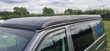

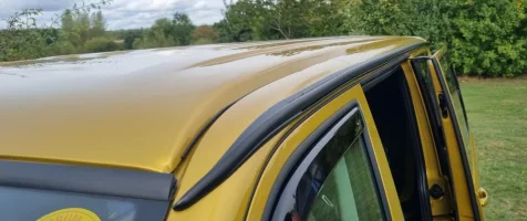

just confirm . . .
is this a Reimo multi rail @Leehoops
and @BoroBoy ( yours has a VAMOOSE logo on it?)
is the Vamoose just a direct cloan of the Reimo multirail?

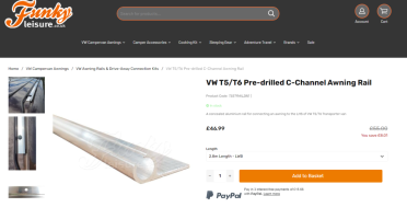

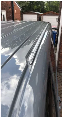

Just a side step on the rail (C-Rail that is) thing . . .
i see some of you had the hidden C-Rail - which i liked. ( which most were using for a side sail/sheet awning)
i found this one that will go on my current van . . . . . . ( as im looking to get a side air awning to swap out the large tent for the time being untill we get the second van)
i like that it fits with the OEM LWB roof bolts - perfect for me, and removable.
£47 - cheap basic offering

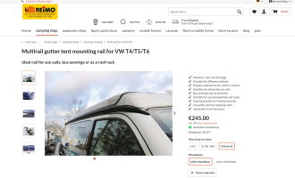

i see this option too . . . .
£99 - looks like better quality extrusion and finish?

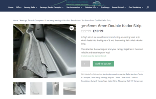

edit:
looks like i need a fitting kit, to go with the drive away air awning,
i see this one,
Description​
If you have a C channel awning rail like the ones I make, I would recommend using an awning bead strip which feeds into the Figure of 8 and the Awning Rail called a Kador Strip. This one has a 6mm (sometimes referred to as a 7mm as it is actually a 6mm core with the material around that which makes it more like 7mm) beading on both sides. This is suitable for standard sized awning rails and standard Figure of 8.
This attaches the awning rail and your awning together in the most reliable and weatherproof way! Simply slides in from one end.
We stock 3m Kador Strips as standard but if you require a different length please enquire. Order yours today!
(If you have a Fiamma or Thule Omnistor windout awning canopy, there is a channel you can use in that, however you will need a 4mm-6mm beading for the Fiamma or the 5-6mm beading for the Thule, not this one).
I have the camper essentials on. Thinking about swapping to the Reimo multi rail.
I have the camper essentials one also, although i dont remember it being that much !
The guy is local to me so i picked it up but that was a few years ago, the rail looks the same as the day i bought it

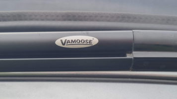

just confirm . . .
View attachment 174509View attachment 174510
@Dellmassive - Yes, it is, as far as I know.
