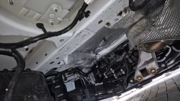

frontwishbone setup.

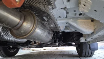

short exhaust and tank layout

not underbody plastics, just exposed body.

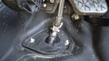

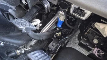

steering wheel shaft and peddle box - no covers.

No protective body under trays
no dash under panels

dont happy with the look of the rear wishbones that look like bananas hanging down.

its a ford transit - thats it.
it looks good from outside, but dont look under the skin if you are used to VAG quality as it just screams "price cutting"
anything that you cant see - has been omitted for getting the price down.
