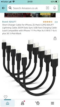

Can any of you guys recommend a good quality ‘short’ lightning to USB cable for use in the van for Apple CarPlay?
If you can see in the picture Chris has fitted the USB for the head unit right under where my phone is, so I only need a cable of about 100mm?
Cheers fella’s!:thumbsup:
Amazon
Just make sure if it isn't an Apple lead that it can do data too as CarPlay is thirsty for data
