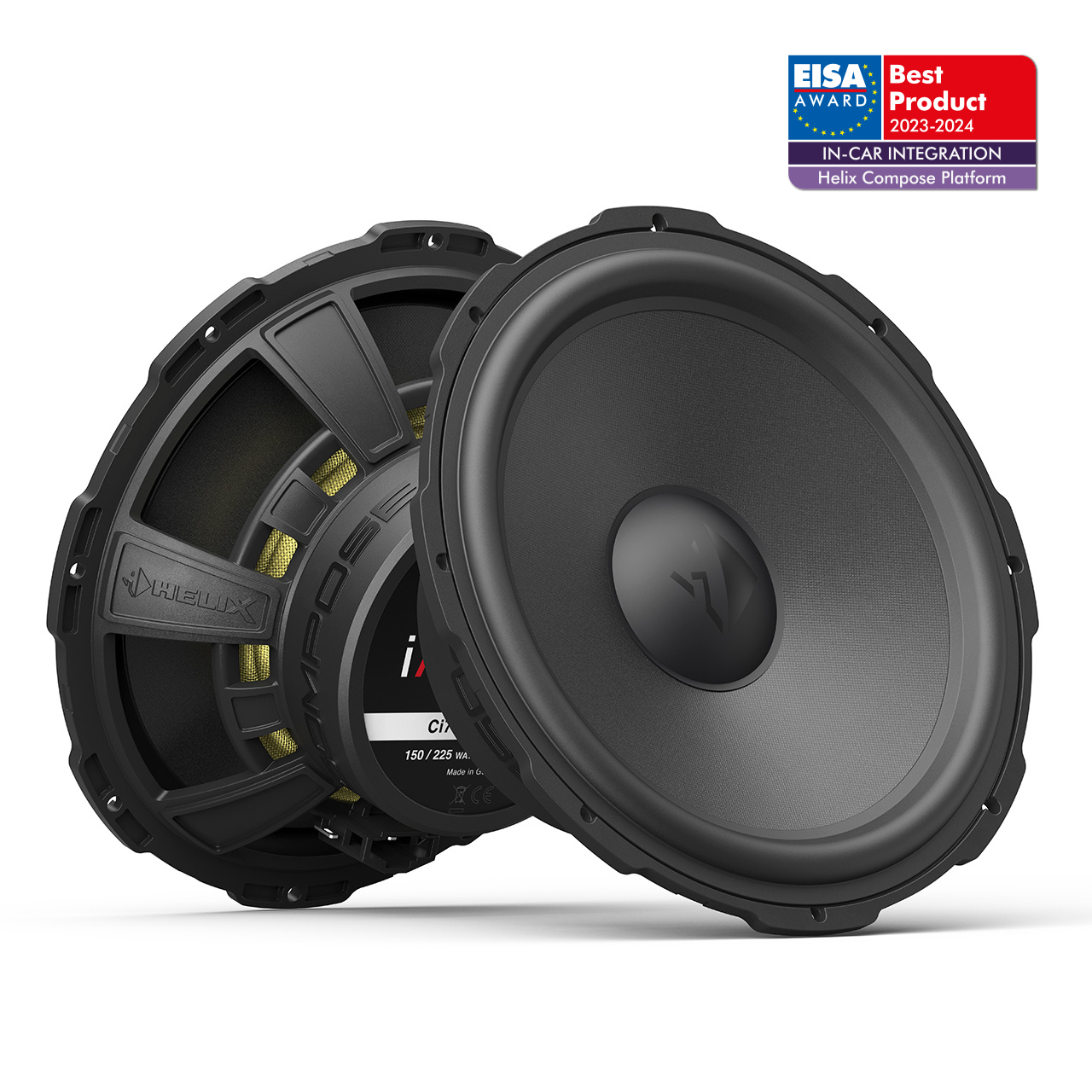

After conducting a swift bit of market research aided by @Pewt , I'm considering two systems - the first I personally would consider 'top end' and perhaps a little OTT; the second more 'realistic' in nature and above all - slightly more affordable:
Helix M6 DSP Amplifier (bridged)
Hertz Mille Legend ML 1800.3 200W RMS
Audison Voce Tweeters 180W
Helix M4 DSP Amplifier
Helix Ci7 W200FM-S3 150W RMS
Hertz Mille Pro Tweeters 120W
I'm currently running an aftermarket Pioneer head unit but am looking to upgrade to an Alpine Halo once I have a buyer for my kidneys. Clearly I've made an educated 'guess' at these components so would welcome any feedback, particularly from recommended specialists/installers @Dav-Tec and @Absolut5 who are very well regarded on this forum. Thank you all in advance.

Are fantastic setup, but are a bit on the expensive side. The ML 1800.3 do require a bit of power for the best returns, so maybe drop them out and go for the Helix 8s as they are nice and efficient . And of course cheaper,
