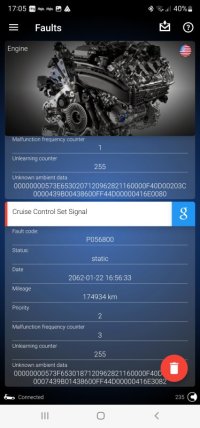

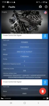

So I have done what you suggested mfsw controls stop working as its connected to pin 36b and I also get these faults

Sorry that's with it all so I don't have faults with mfsw working I will change it again to get the faults back up tomorrow and post this is the instructions I got with the loom so you know what I have done
