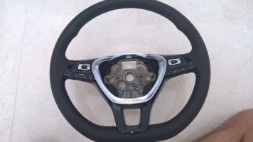

BCM: 7E0 937 090B i have instaled MFSW - get photo
My friend say, you have bad BCM unit - you have "B" - this model dont support CCS? it is true? must i buy new bcm?
The BCM 7E0 937 090 B supports both Cruise Control and MFSW.

All 7E0 BCMs support CCS and ACC.
Actually why don't you go for ACC?
