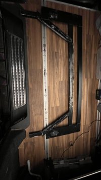

Work underway on the floor now. The seat rails added some complexity. 15mm ply (left over from the lifting bed base) glued in the spaces between ribs. 9mm insulation board glued on the ribs.
The floor is 18mm Ultralight ply/XPS sandwich, with another 5mm ply layer on top, and will have 2mm Altro over it. To fit the along rails, I had to rebate a channel, and plane down some of the packing where the van floor isn’t flat. The B pillars had to be trimmed at the bottom.
Side step, I got a Caravelle one. It needed longer clips and some packing underneath, following @Deaky advice.
Rear threshold- I had to trim the plastic threshold to the edge of the floor, and put edging strip along.
Narrow sliver of floor was a supported on a festival of packers and glue.
The biggest challenge was getting the floor to meet the taper of the walls. Because of the thickness of the floor the edges of it are very 3D.

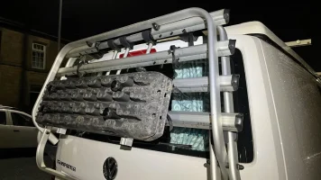

I built a rack to carry the recovery racks tonight. Two 300mm lengths of 4040 extrusion. M10 studs carry the racks, secured with long handwheels. The 4040 is secured to the rack with M6 button head bolts, with 15x30x2mm alloy washers (drilled and cut from strip). I’ll do some more photos of the rack in daylight.
