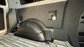

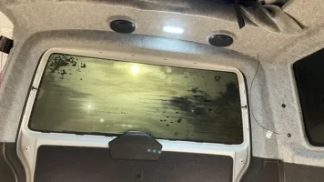

thank you, much appreciated.Yes, I’ve got the ABS trim for D pillar and wheel arch cover, as I’ll have mucky MTBs and riders in there. The D pillar trim fits well under the tailgate seal, and is held on with double sided tape on the front edge. The top edge traps the carpet down neatly. I will need to put a fastener in the top right hand corner, as it won’t stick down over the carpet at the top 10mm (onto metal of D pillar below). If you go for the full height trims that wouldn’t be a problem, but then you have plastic instead of carpet in the sleeping space.

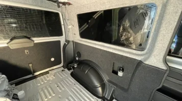

The wheel arch trim had a cutout for the jack mount, but I had to trim that a bit more to fit.
I’ve only got carpet under the top edge, so if you have carpet all the way down, then they will need a few fasteners on the edge at the front.thank you, much appreciated.
i will be to fit these over carpet so thanks for suggesting it works!

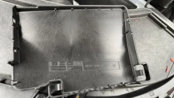

Love the storage slot cut out…wishing I’d done something similar when I trimmed my van!Rear Fusebox in, with a circular access panel that doubles as a slam vent. There’s a pocket cut into the void space with a USB port for the passengers. Plastic wheel arch covers are intended to be easier to clean than carpet in this area.
